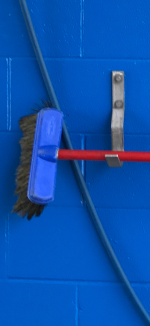

Waxman set up looks great only thing I will say is I tried those hooks from KR before. They wont work if the customer places the brush head towards the wall. Wouldn't be a problem for people who actually use their brain but most dont. People would just leave the brush on the ground when it was too complicated to figure out that they need to turn the brush around. Jim Coleman sells SS J hooks for foam brushes. I cant remember how much they were but im sure more than KR, it’s worth it because they work and are idiot proof plus you don’t have to worry about the brush being run over. The J hooks extend out from the wall. Ill attach a pic its not the best because I cropped an old pic but you can see how the J hooks protrude and extend the brush away from the wall. Just a thought.

maybe I could try bending them like the ones in your picture or putting some spacers behind them before I put them on
