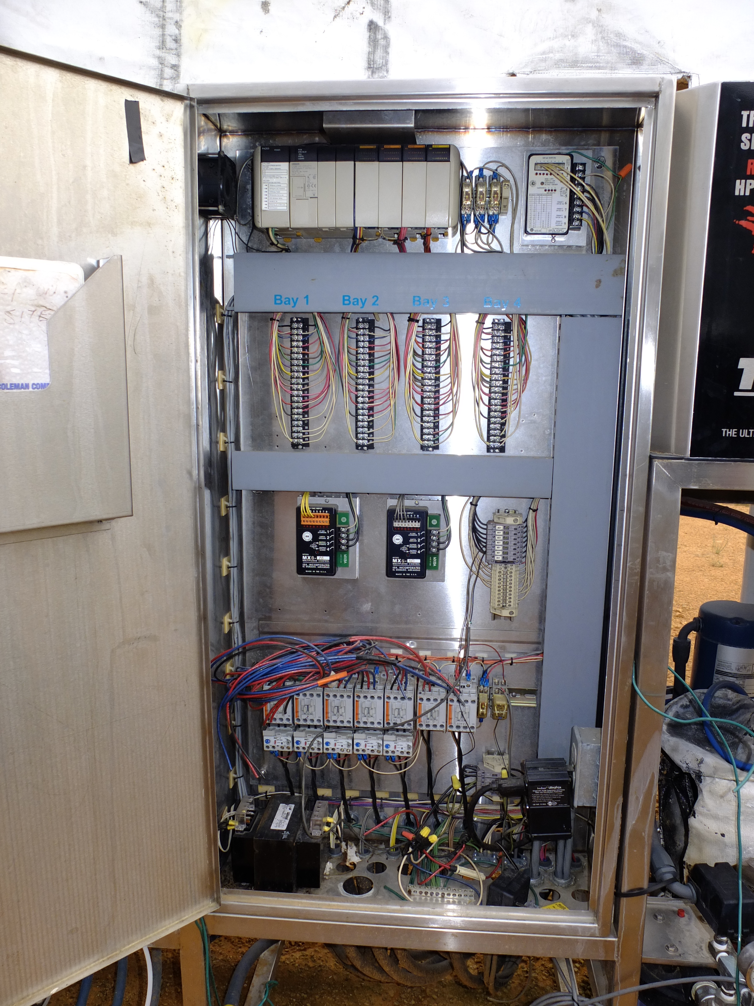

wow my Super Saver pumpstand wiring is totally different then that!!!??????
Here is your Coleman plc unit (mine doesn't have a plc).... I think the ryko is built better. But the control unit seems crazy. The unit also has a red lion not pictured.
Also both units were pulled from a working environment.
