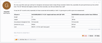

1/4" has more pressure loss.
I dont think it's probably more than 5-10 psi. Greg P did a review with mosmatic comfort hose which is similar to 1/4" hydraulic hose. I will say though the hose might wear quicker on a radius like where it connects to the gun since its thinner then 3/8". Overall after two month my customers have loved them especially the women. Very lightweight. As long is it last 6 months that good for me. It's never fun standing on an icy ladder in the middle of February getting drenched with the weep while changing a hose. I change all my hoses before and after winter to be safe.

We have the Mosmatic comfort hoses and we love them. I thought they were a lightweight 3/8" though.
Pressure loss should not change as the controlling factor is the nozzle. Each nozzle has a max flow rate based on the opening which does not change. The mosmatic hoses are nice and lightweight but can be kinked easier than the thicker hoses.
