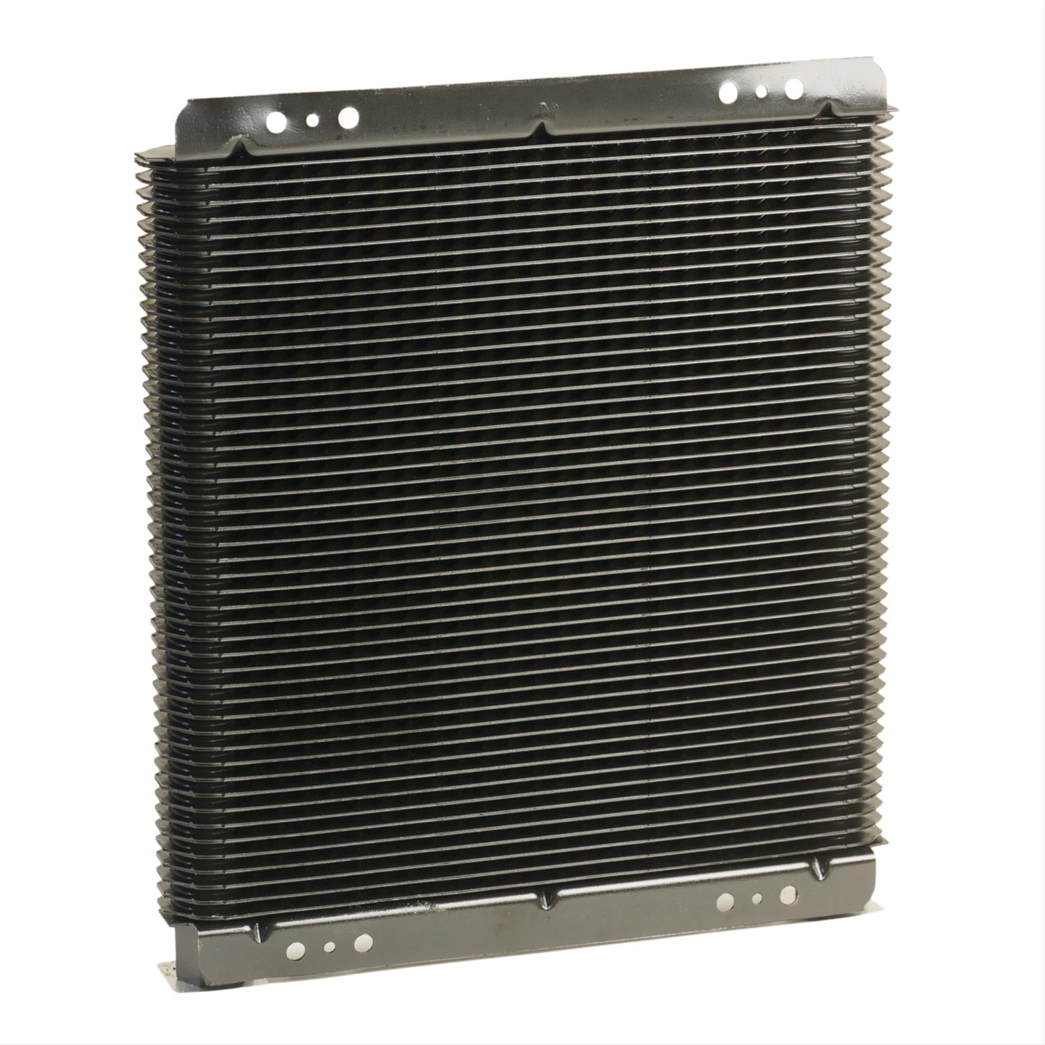

My moisture problems were eliminated after I installed a heat exchanger between the compressor and the tank. A fan was installed on the back side of the heat exchanger, and runs whenever the compressor runs. The hot compressed air enters the heat exchanger, and any moisture condenses out the bottom as it gets cooled. A water separating air filter is then installed on the output of the heat exchanger, and collects the condensed moisture. An automatic drain periodically dumps the water.
Here's a link to the heat exchanger I used:
