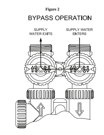

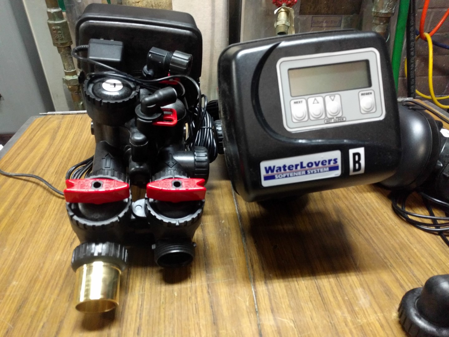

Looks like this softener might have a bypass built into it? I won't need to reuse all that plumbing above the current one to bypass the softeners? I didn't get a manual with this thing for some reason... but water guy PM'd me that it's a Clack and I found a manual online that looked like it has a bypass?
Usually the head has a built in bypass, but you’ll want another one in the plumbing as well. This may come in handy down the road, like next month, next year, next decade. But sometime you’ll be glad you put one in.
Agree. That allows you to bypass the entire unit in the event you need to remove it for service or replacement.
