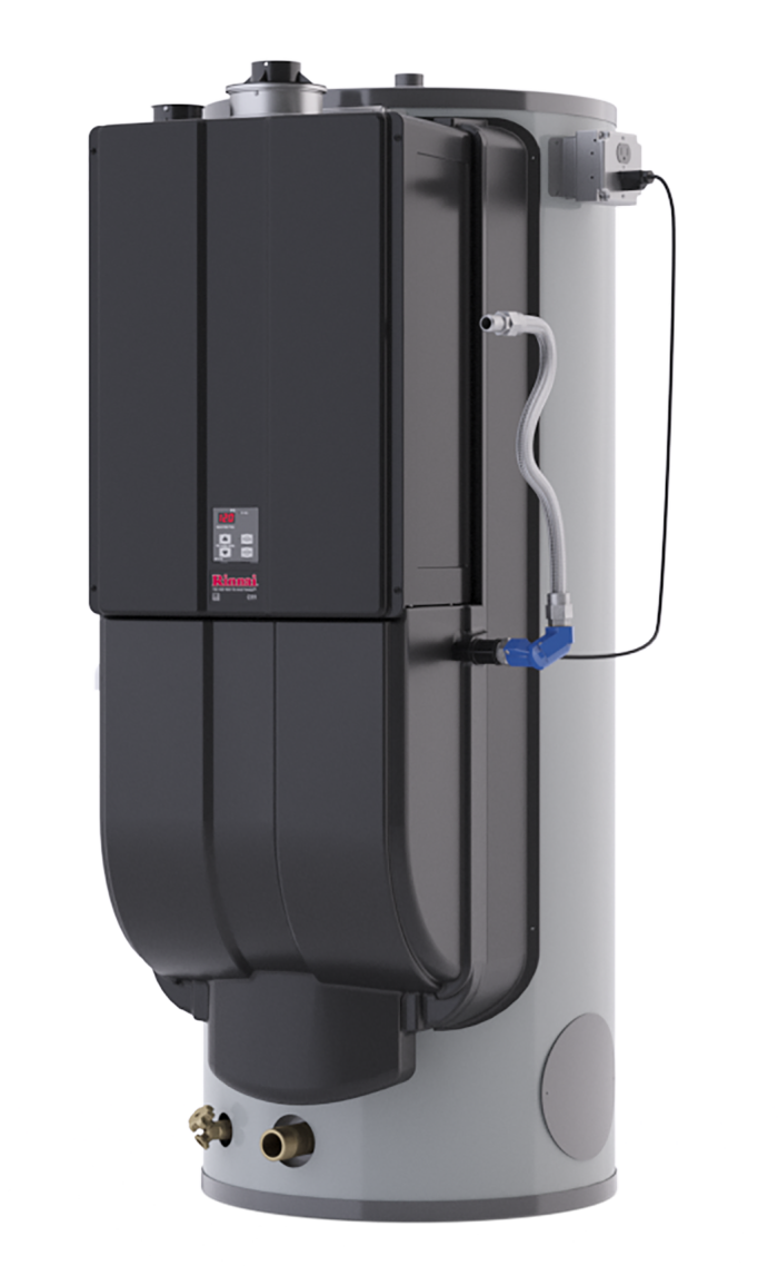

Thanks is Rinnai CHS 199 100 HIN, a tankless heater with circulating tank? Here is the link to it:
You can get a heater and tank plus a circulator pump for under $3,000. A simple hookup would be to use a tank mounted thermostat to turn the pump on, which will trigger the heater to run and heat the water in the tank.
The one you linked is over $8,000.
Nov 13, 2017
285
11
Calgary
Exactly that $8k USD changes to $12k CAD when it makes it to Canada. These Rinnai ones seem to be a combination of both on-demand heater attached to a circulating tank as you described above.
