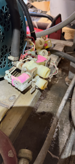

Because the system has a Dole valve, I believe your system features hot water wash/cold water rinse. If true it’s possible you have an open circuit in the coin box wiring that energizes the cold water solenoid valve.
So, after the new pump was installed, the first successful “test” was HP Soap…indicating the Dole valve’s hot water solenoid is working.
Then, you selected HP Rinse which resulted in your low-pressure condition. This indicates the Dole valve’s cold water solenoid valve is not opening, or the cold water supply to the Dole valve is restricted.
When the cold water Rinse selection starved the pump it might have air-locked the pump. That air lock must be relieved so the pump will function properly…easy fix: remove the bay’s trigger gun and turn on the bay to HP Soap. Once a steady flow is achieved, reinstall the trigger gun and run the pump again.
To determine if you have an open circuit on the cold water side of the Dole valve, select Rinse and check for 24v AC at the cold water coil. No power? Look for a disconnected wire on the second stack of the rotary switch’s Rinse terminal.
