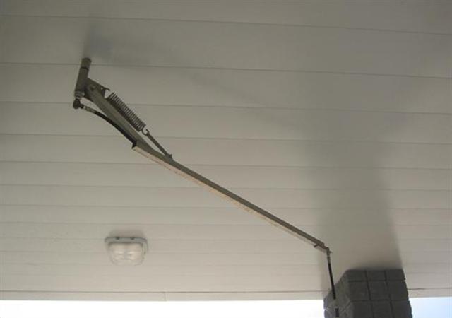

Also this one.... not sure what manufacturer. But someone might be able to identify it.
