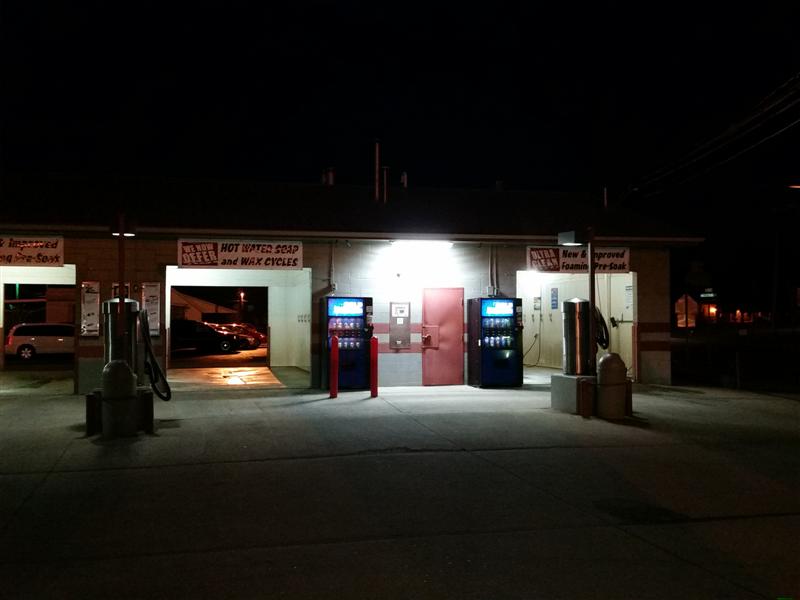

Here is a picture of the 66w LED 4' 3 bulb fixture I put over my changer and pop machines.....Each bulb is 22 watts....Puts out an advertised 2750 lumens per bulb...No external driver or ballast...Runs on 120v...The lights in my bays are 85w CFL for comparison...The bulbs in this fixture have a clear lens. When I replace the CFL's in the bays, I'll probably go with frosted bulbs because the clear lens produce shadows....You can see the streaks on the concrete. The frosted bulbs don't do that. But for over the changer, its hardly noticeable.
BTW...These 3 bulb fixtures are about $80.00 including the high output bulbs....

Yes...The 4 foot fixture is vapor tight. I'll post a close up of the fixture later this evening. I just installed the fixture, so I haven't made it through a winter yet. I'll post a link to the website this evening as well. Don't know how to copy and paste links on this smart phone yet!
