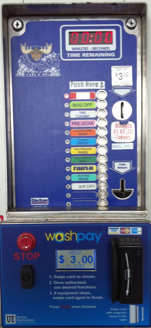

Kleenzcars,
I struggled with the same. Up here in Canada we have $1 and $2 coins and I have an ATM on site. So people could just go to the ATM and get $ for the SS bays.
But in the end, I didn't want to stop customers from giving me money. It's nowhere near the usage I was looking for, but CC users do spend more (over 20% more. Also, I can now offer gift cards and commercial accounts that can use my IBA, SS bays and petwash under the same system.
My system counts up in both time and cost.
Here's a couple of pictures
I use Mercury Payments with the Unitec equipment and internet CC clearing. I find their fees reasonable.
