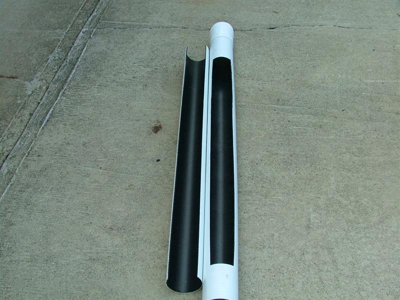

I have 5" drainage pipe in my attic for 3 bays, basically the full length of the building. Then it tapers down to 4" where it goes up to the top of the gable end and out the building and along the 4"x6" I-Beam to my truck bay. This piece is just an extension I made to extend what I already have along side the I-Beam. Its easy to cut. I just use a table saw and cut it like the pictures and it will snap together to make an air and water tight seal. Its also easy to get apart. I've had this stuff out in the direct sunlight for many, many years and haven't had one bit of trouble. It was installed long before I bought the wash. It comes apart without breaking. I also seal openings where hose comes through with Gorilla Duck Tape. Its not cheap, but its the best stuff I've ever used outside. I had some on the trough above the truck bay and was able to peal it off 2 years later. It looked like the day I put it on. Great stuff. Hope the pics help....BTW...Got it at Lowes....
