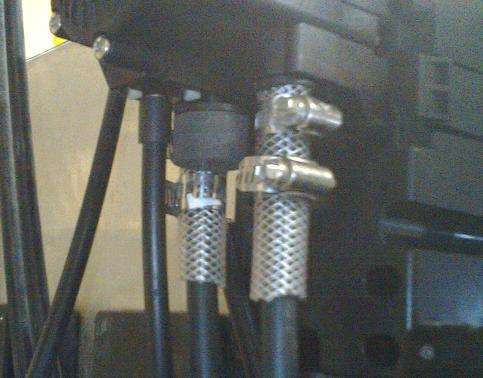

I have Gates push lock hose. It is 3/8 I.D. and it won't fit over the flowjet fitting at all.
If you can't get 3/8" hose to fit over the barb, then you must have the bigger G57 pumps which have a 1/2" barb. You can either do the "hokey" fix as mentioned or replace the barbs at either end and use 1/2" hose the whole way.
I almost ordered some 1/2" tubing fittings for the FloJet, but they're $13 each! Screw that, my tubing-inside-hose-and-several-clamps-around-it is holding.

I don't install the hose over the Flojet barb unless there is a good reason. I just push back the plastic retaining clips, slide the whole barb/hose out of the pump and reverse to the new pump. Check the o-rings in the barb tho.
Exactly what I do when switching out a pump. Bubbles Galore is doing a new installation however.

I must have the 1/2" barbs then, what a mess. It shouldn't be too hard to get things fixed up then. I didn't realize that the pump came with 1/2" barbs. Another lesson learned. Thanks for the help guys!

I hate to say this but that looks like its kind of ?Hay wired? or ?Jerry Rigged? Did ?Plumber Joe? do that?

I have to admit that fix does look primitive but sturdy.
I meant it to be temporary - I had the smaller FloJet pump on it which fit the tubing, but it failed so I put that pump in its place. It just circulates water over powdered soap in a basket so there's not much pressure on the fittings, and I just never bothered to change it. As I said above, I was going to order the proper 1/2" tubing fittings, but the cost was ridiculous.
