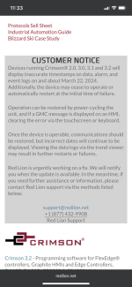

Devices running Crimson® 2.0, 2.1, 3.0, 3.1 and 3.2 will display inaccurate timestamps on data, alarm, and event logs on and about March 22, 2024. Additionally, the device may cease to operate or automatically restart at the initial time of failure, and the Log File is created/begun with 1 Jan 1997, and data is logged in to that with Time different time stamp.
