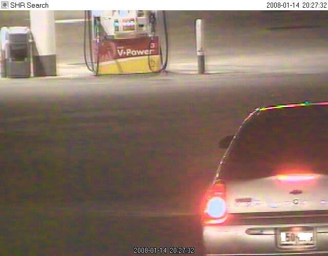

I have an auto tracking PTZ at the corner of my wash that always "watches" the entrance. I actually have 2 of them, but they aren't cheap - they were about $800/ea. Besides that, every camera (16 total ) I have at my wash are able to get legible plate reads - even digitally zooming. I'm running 4MP Hikvisions - some 2.8mm and some 6.0mm.
About 10 years ago I installed cameras pointing at the entrance and exit. They weren't very high resolution but the DVR would only capture 640 x 480 so the cameras didn't need to be high-res. The cameras are about 100' from the drive, and I mounted them right above a light so the reflective property of the plate really helps get it read.
