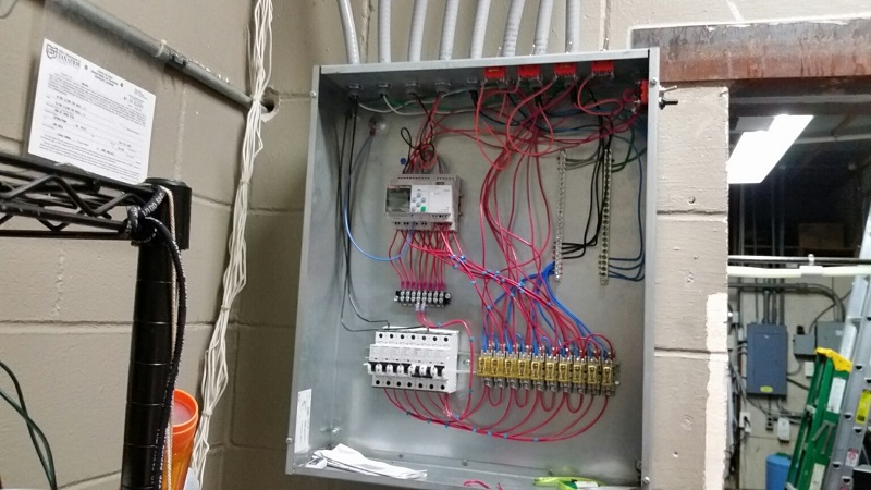

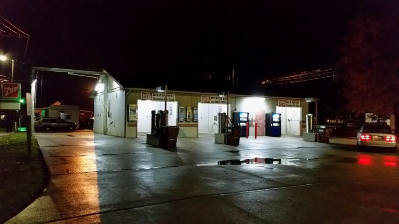

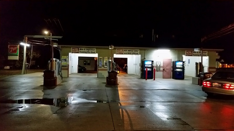

First of all, thanks to CantBreak80 for planting the seed. I finally got my new PLC Controlled lighting system installed. Some History and numbers for comparison….Original lights, High Power 175w Mercury Vapor, 100% of Dark Hours, 2100 watts per hour. In 2011 I put in 85w CFL Retrofits, 100% of dark hours, 1020w per hour. Recently I installed a PLC Controller, all new wiring, and LED (3) 4’ bulb fixtures (4 each) in all the bays, twice as many fixtures as Mercury Vapor and CFL Retrofits. From on time (Dusk) till 10pm, All lights and tubes are on including vac and changer lights, 966w….After 10pm, 2/3rds of all bulbs turn off and leave only center bulb on for security. If someone uses a bay after 10pm, after the timer starts, all lights for that bay light up. When time runs out, there is a 5 minute delay before switching back to security. Total security watts from 10pm till dawn, 318w per hour, a significant savings over the CFl's….Its actually amazing how much 318w of LED's light up the wash when I stop by at 6am on my way to work. Customers seem to love it. Night-time use has increased. The Pictures tell the tale!

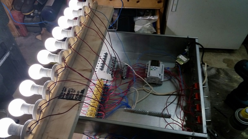

Testing the Concept and Programming before installing
Control Panel with PLC and Individual Relays to handle the load. Not quite finished, need to tidy up the wiring when I snapped the pic.

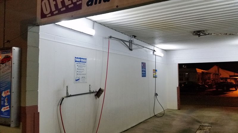

LED v/s CFL, The truck bay and both bays on either side of the ER are LED. The remaining bay is CFL, 5000 color, same as LED's....Huge difference in color and lighting quality between CFL and LED.

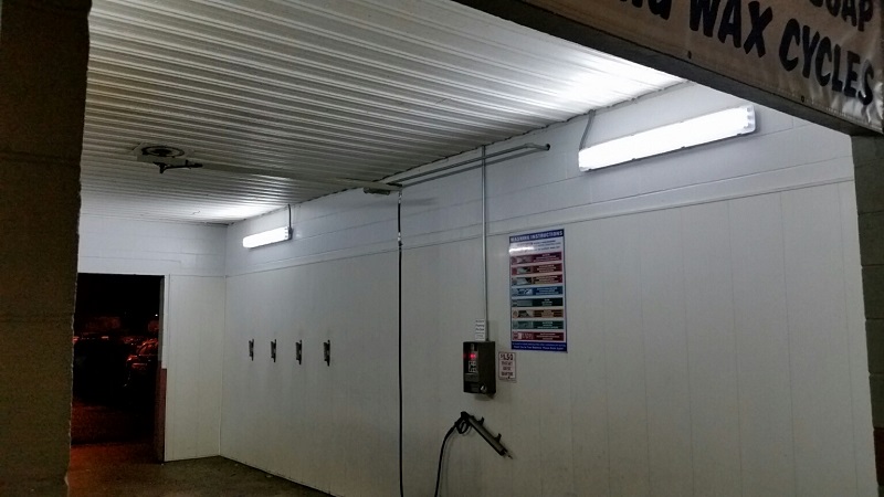

All lights on...
3 bulb IP67 rated 4' fixtures...(4) fixtures for each bay. 56w per fixture, 18w per bulb.

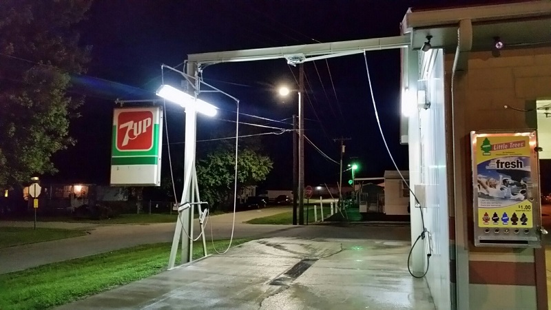

Truck bay with new SS angled shields for two of the 4' fixtures. Plenty of light, even for the outside bay!

Here's some pictures I snapped this morning at 6am....392w of total security lighting for the whole wash including vacs and changer. Each of the 4 bays only have (4) 18w bulbs lighting them. The changer (3) bulb light (56w) is completely lit for contrast. Note how much light is in each bay on just 72w total (Security mode)....Yes, only (1) bulb is on per fixture in each of the bays.
