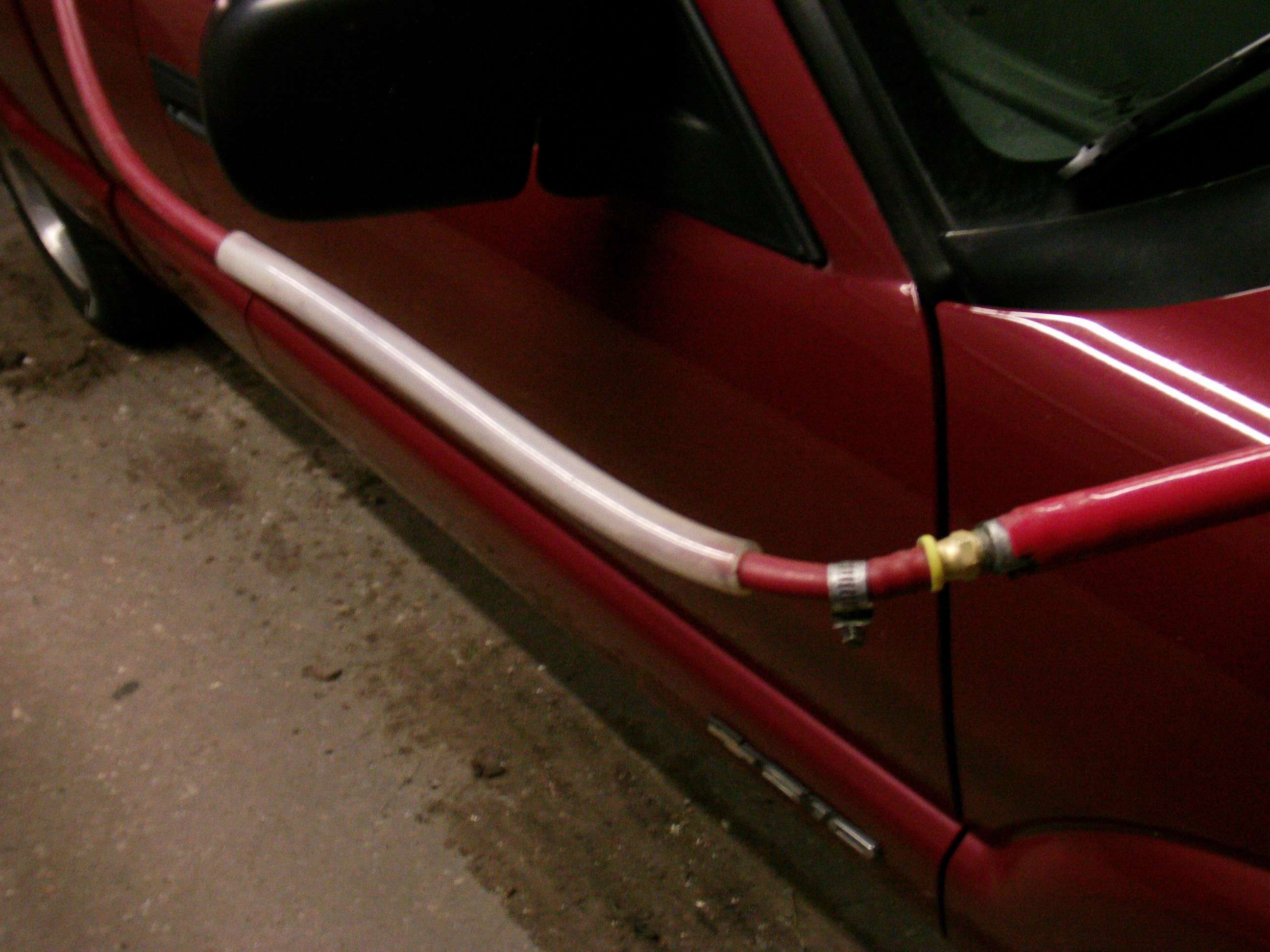

This is the crappiest bend restrictor I've ever seen (I don't know why there's even a hose clamp on it except to cut customers):
I use GoodYear Insta-grip hose and a plain black rubber bend restrictor from Kleen-Rite. The blue hose won't mark cars, it doesn't kink, and it lasts about four years.
