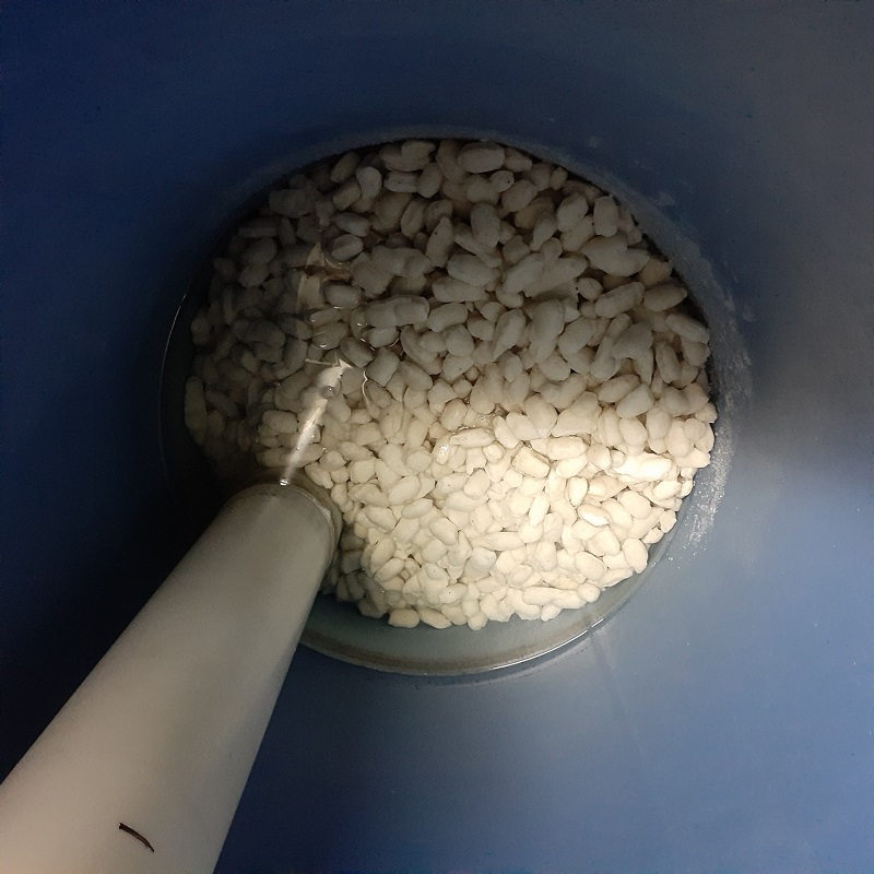

I bought about 10 bags of Mortons Clean and Protect Salt at Sams Club in the 44# bags. When I put the first bag in my softener brine tank, I noticed the salt wasn't bright white like it always had been. Its now a dirty tan color....I am wondering if I got a bad batch of salt or is this what they have switched to? Hope it doesn't mess up my softener! Anybody else seeing this?

I buy the same salt from Sams - the pellets used to be cleaner than the crystals, so I've always gotten the pellets. But not for the last few years, it is definitely not as clean as it used to be.
I just cleaned out my brine tank yesterday afternoon, I was irritated at how quickly the dirt had accumulated and the water looked gray.

We've heard this complaint about Morton's pellets many many times from all sorts of softener users for years. This is a good reminder to clean out your brine tank at least once a year. If you've never done that, you'll be shocked at the amount of gray/tan crud in the bottom.

Just dumped a bag that we picked up this week and it’s Snow White. There is a number on the bottom of the bags, maybe a batch number? Worth giving them a call.
I think what you have is the yellow bag or regular pellets. The poster is talking about the green bag (I believe); it has an iron & rust fighter supposedly added. I just got 2 bags for my home, and it looks the same as his.
