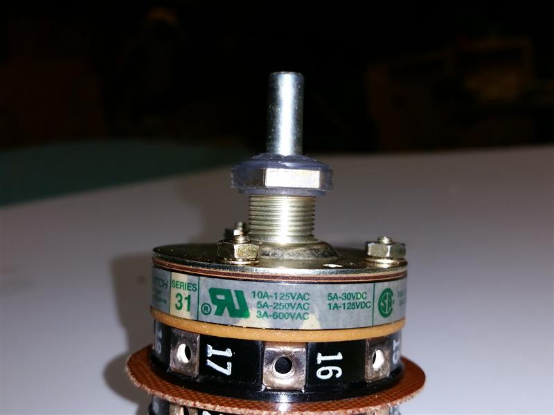

You might also do a search here on "rotary seal"....If you add a shaft seal like the one pictured, you probably won't ever have to change a rotary again. Water infiltration is the killer of these switches. Also, there has been lots of discussion on here which switch lasts the longest, Shalco or Electroswitch....Doesn't hurt to do some "Searching" to see why one might be better than the other? FWIW I use Electroswitch...

Also-- good tip on the seal to keep the water out. Makes complete sense that water is causing all the problems with the switches.
We got up and running yesterday with the new switch. But I'm going to look into adding the seal.
