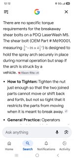

Are you tightening the shear bolt to the proper torque specs?
Never have in 20 yrs
No wonder they broke every month. PDQ even specifically calls out premature failure if they are overtightened. I'd recommend acquiring an actual service manual for you machine instead of using Google. If you have a 360 arch, get the portion that covers that as well.
It's 20 ft-lbs for those that are curious.
