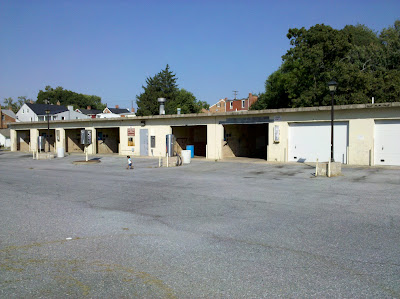

I might have an opportunity to lease a self serve wash that is very old and worn out. It has a total of 8 bays: 6 are self serve but only 3 are functional. 2 of the bays are enclosed on one side and have a roll up door on the other. These presumably could be used for a detail shop.
A buddy of mine that drives part time for my courier company knows the owner of the wash and the same guy owns several adjacent commercial properties. My friend is a veteran of the detailing business. He would like to take on the lease, but the place needs a lot of attention and certainly would require some money to get things up to snuff. He doesn't have the money right now. I told him, I would take on the lease and rent him two of the bays to to kick off his own detailing biz and I would get the self serve bays going and try to make some money from that.
I would make an office out of one of the closed bays for my courier biz. Below is a picture of the place and a link to a 22 sec video driving by the wash. The city population is around 60,000. There are 3 other self serve washes in town. The other washes are within 1-3 miles of this one. The traffic per day if I read the traffic map correctly looks like 6,100 cars per day.
According to the owner it brings $500/mo right now. As you can tell it's totally neglected and has been for years as far as i can tell.
I wouldn't be relying on the income as my other business supports us fine and is pretty stable. This would be a supplementation and cheap rent for my office and there is room to keep my courier vehicles on the lot.
I like the idea of the challenge and the potential to turn it around and bring it back to life.
What do you guys think? Is it worth it or just too much a pain to bother with?

That place looks like a money pit to me. Getting it running properly and some curb appeal will suck up a lot of money. Even if you accomplish those things you will still have to overcome it's present reputation. With a 6100 CPD traffic count I don't see much potential.

500/mo gross is extremely low. You would have a lot of reputation repair work to do along with the physical repairs. Personally I'd seriously think about taking on the challenge. Since you'd be using part of it for your already established business, you can spend time fixing things up and slapping some lipstick on that pig. Before I'd try to attract business, I'd probably focus on getting everything in working condition so you don't upset any new customers.

The place looks closed-that can't be good for business. Kill the weeds!
