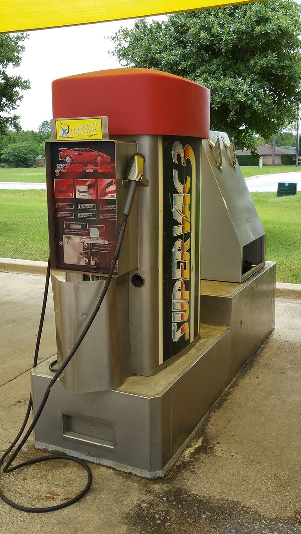

Are they so proprietary that they cost a fortune to keep going? Does anyone regret going combination? My wash is too small for all of them, but I might try installing one of the Fresh-N-Vacs. I like what Earl W. did with the fragrance lighting on his. I think I remember seeing a video link to YouTube on here awhile back.
I've never had a combination vacuum. I upgraded with 2 IVS 3 motor vacuums awhile back...happy with them. I'm thinking I would only try installing one of the Fresh-N-Vacs. I don't know why, but the Scub-N-Vac just looks like something I could end up regretting. I might be looking at things all wrong though.

They are troublesome. I'm in Ont Canada and changed them over to just Vac. They froze up in the winter and the odd customer who used them got p....d off!

I might just pick up a couple of the plain Jim Coleman SuperVac 3's. I don't think freezing would be nearly as much of an issue here though. They are all oval. I don't know if the large hinged door makes for easier clean outs/filter changes? I haven't gotten the keys to anything yet. I'm meeting to discuss price, and which units I want tomorrow.

I went from 6 super vacs to 8 combo vacs. Love them. Not hard to maintain and they get used. For fragrance, I use oil based and it doesn't freeze. I put winter shampoo in the cold months for those and rarely have an issue. Only issue with fragrance I've had is the solenoids get gummed up sometimes, so I take them apart and clean them and they are good to go. Usually only on the wild cherry for some reason.

They are a little rough. This car wash was shut down because the owner said vandalism and the theft got to be more than he wanted to deal with. I think I can pick them up for 100.00 each. Clearly they've had some vandalism, but they should clean up okay.
They're pretty reliable but they're not easy to diagnose when there's a problem. I'd gut them and go to IDX timers and toggle switches like the Fragramatics uses. There's no reason for a vac to be any more complicated than that IMO. The original Doyle Fresh Impressions were controlled by just a rotary switch and they're almost 100% reliable.

No real issues for me except with the B&C timers, the button on shampoo handle going bad, and dirt clogging up the shampoo lines . if those have the full length door I'd snatch them up. Put a dixmor timer in them(even coleman has gone to dixmor in their new vacs) . Wipe off the top of the vac before you add shampoo and your clogging issues will decrease 90%. Don't submerge your brush in a bucket of water to clean it. Rinse it off with a garden hose or pressure washer instead. I'd rather have these over fragramatics, mainly because I cuss every time I have to do anything to the vac motors on the latter. Changing brushes on a coleman is a piece of cake.

I agree with cfcw, and those don't look that bad at all. Very easy to make them look like new. I buy some parts from Coleman, a few from KR. I would throw a Dixmor timer in there if you need a replacement. I did notice that Coleman started using those in their new vacs as well. I like both, but shampoo/vac probably gets more use and at $2.50 to start, makes more $.

That helps a lot...and yes, they are the full length doors. I'm meeting with the guy tomorrow...I may just pick them all up, if I can get them all for 100.00 a piece. I sure won't be installing them all, but in parts alone...will be worth it to stick them somewhere in the meantime. I would never have guessed the shampoo vac was the one more customers would use, but that looks like the consensus...from going back and looking at older threads on here.

They are worth way more than $100, so if you have to pay more, I wouldn't hesitate and would buy them all anyway. Like you said, parts alone are worth a lot.
