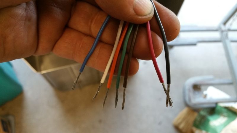

Has anyone switched to the Dixmor LED6 in a Jim Coleman vacuum? I'm not sure which wire goes where on the new harness that came with the LED6? I've got the blue, white, orange, green, brown, red, and black coming out of the Coleman...that originally went to the 1034R.

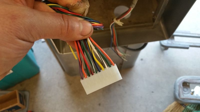

There is the smaller second plug in on the 1034R...I don't get how that would workout? I guess I need to actually unwrap the led6 and study it. I'm only familiar with the earlier Dixmor timers in my bays. I'll study it a little closer tomorrow.

No need to connect the smaller plug. It's for use with combo vacs or bay timers.

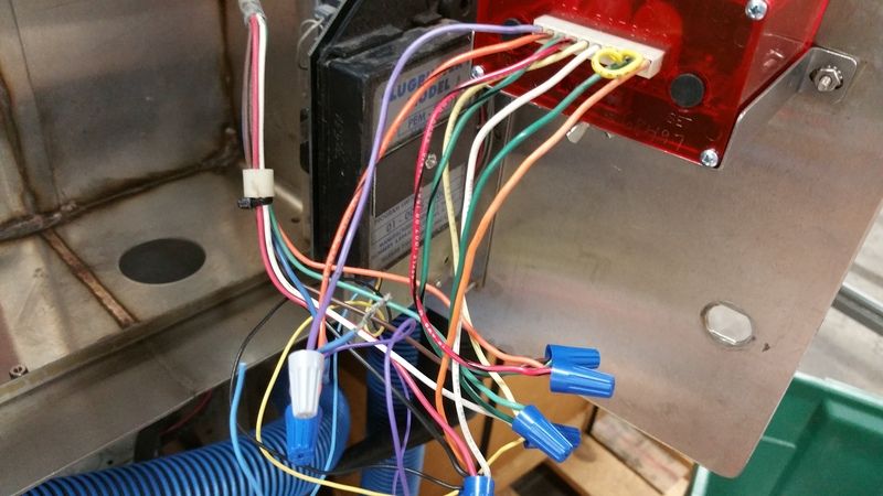

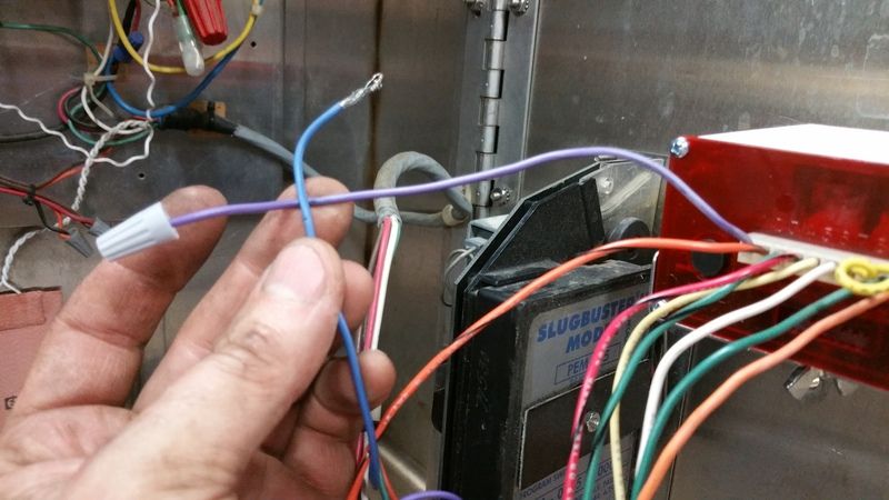

I removed the smaller plug...but I ended up with some problems. The purple/Line 1 on the LED6 harness isn't in use? Also, there is blue wire coming from the wiring harness of the vac...and I'm not sure if it's needed, or where it goes? The vacuum starts and runs great. I'm able to program the LED6...no problems...BUT, I have no sound when a coin is deposited...and no sound for the first 10 seconds of last minute countdown. You can see in the last picture...I can't tell what the blue wire coming from the vac harness even goes to? I guess I can pull the tape off...and try to see. I thought I'd ask you all first.

Purple wire doesn't go to anything, I can check the schematic and let you know about the blue wire tomorrow.

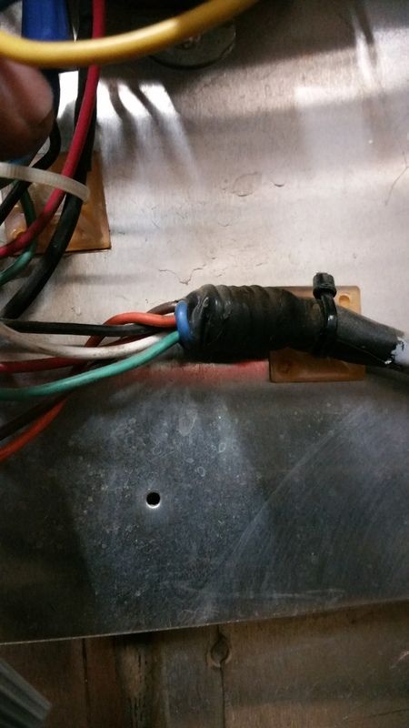

The blue wire was only used as a wrap at the top of the harness...wasn't connected to anything. I guess it's possible I messed up the ability for the LED6 to send a signal for sound somehow? I tried another buzzer...and nothing...reversed the speaker wires on that one as well. I'll stick another LED6 on in a few days...and see if it's just this one. If so?...I'll gather up some old ones to send for repair with this one.
