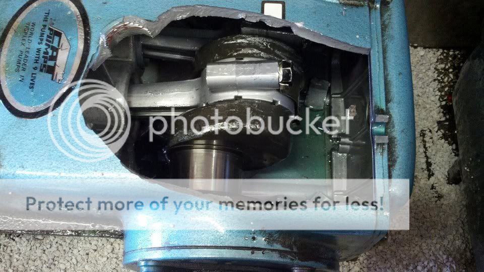

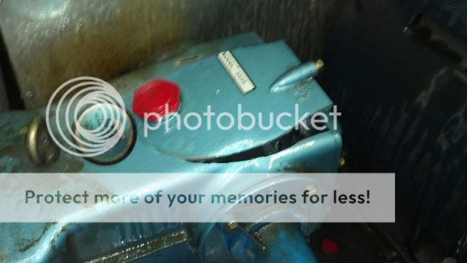

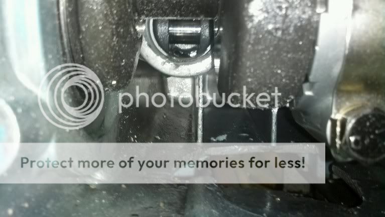

I forgot to mention there is hole as big in the bottom of the pump as well. I might need a lot of JB Weld.

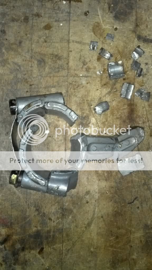

Not sure how long it has been service or how many wash's are on this unit I have been maintance for 4 hrs. The previous guy said it had been replaced once before unsure when. He was an older guy that develpoed alltimers.
Yes I do regular oil changes.
The first connecting rod as your looking at the pump broke and I thinking the parts got wedge and forced the case to break.
Unsure about other damage. I was so mad and it takes a week to get a pump. I went drinking instead Ill worry about it on Monday.

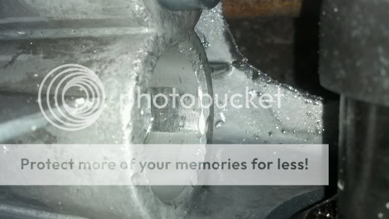

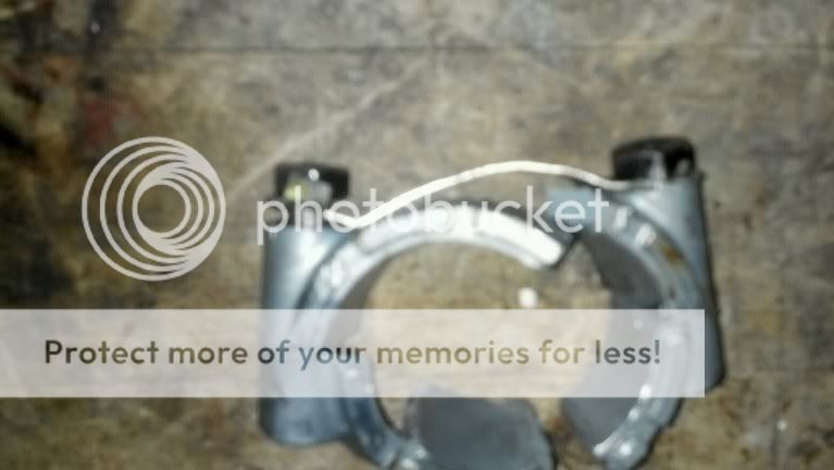

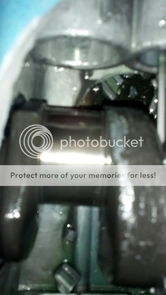

What I find odd is that the rod throw on the crankshaft is not damaged. Most of the time a pump or an engine throws a rod it is because of low oil and the rod welds itself to the crankshaft. Then it either siezes when shut down or snaps while running which causes "massive oil pan and crankcase failure". I'd like to see the rest of the parts. Maybe a rod bolt broke?

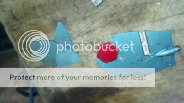

Thanks I will contact them Monday morning. Iam going to tear into Monday too and see if I can find WHAT caused the failure. I will take some pic of the parts that I get out and post them for you to look at.

Looks like a top end failure. Piston or top of the conecting rod. As said in an earlier post there isnt any signs of the bottom end being compromised. Is the piston siezed in the bore or did it come apart? Ive seen lower ends(of racing engines) come apart and alot of times the upper part of the rod is somewhat intact. Doesnt take but a few seconds to cause catastrophic damage when one end or the other comes loose. Doubt you would ever get any warning with this kind of failure. Sorry, bad pun not intended.
