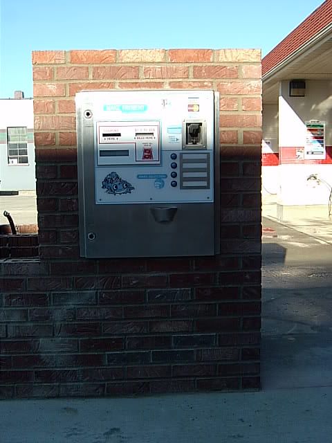

My first project is removing this ACW to install an HTK
As you can see, most of the work will be brick and mortar demolition. I also have a right angle grinder to to "dress up" work. That grinder is the handiest tool I have and lives in the truck with me.
