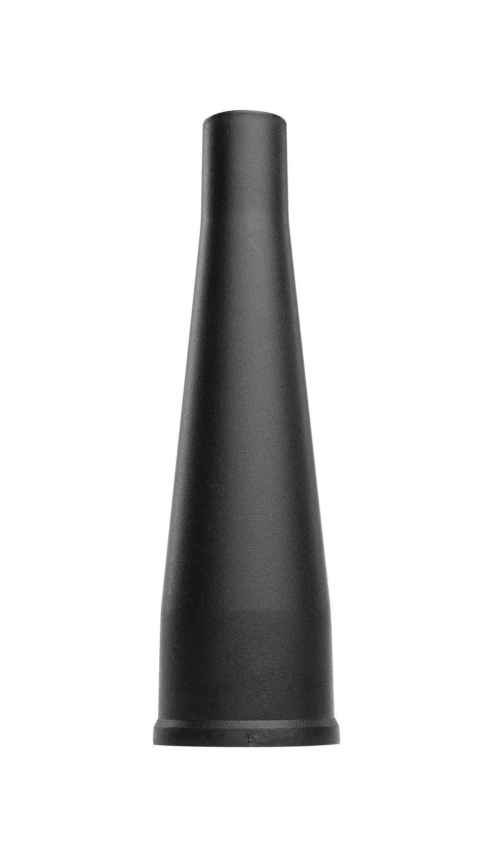

Wonder if people would struggle to hold the hose/nozzle without a pistol grip? I'd buy a strain nozzle for like $15

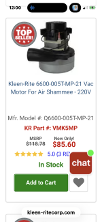

Asking for a buddy… what replacement motors do you use for the air logic dryers. A buddy has gone through like 15 motors in less than 1.5 years since replacing these from originals that lasted longer. He’s been using shammee motors which I said may be the problem for that system. Thx

These motors intended for the air shammes dryers. I try to change out brushes at 200 hours to maximize life.
But he has an Airlogic 3 vac motor dryer, no support now since out of business. Kleenrite was unable to provide my friend which motor specs were intended for this system.
The first year or so few or no issues. He Didnt swap brushes and had to replace motors which he replaced with these. Hes had a lot of issues since replacing with these motors.
Thats why I was asking which motors people use with the Airlogic system only.
His was is in a very hot environment in the summer. I think that has something to do with it when someone uses the dryer for 10 mins straight in 100 plus weather. But then again it was hot that first year or so with few issues.
