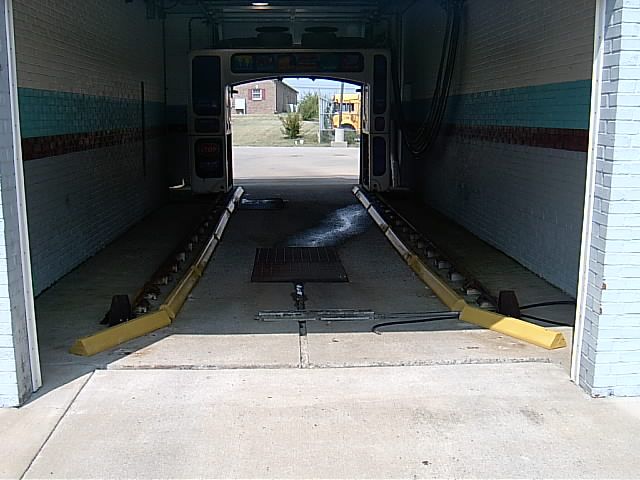

I would look into buying some old entrance rails and converting them into exit rails. I have them from old Automatics and I feel sure many others do as well. Also they should be readily available from used equipment dealers.

I got them from www.recycledplasticman.com The web site doesn't seem to work now. I just bought them last summer. Below is the contact info I copied from an e-mail from them.

No problems at all. They still look as good as they did when we planted them, and work as well as we hoped. You couldn't give me a set of guide rails after having these.

Sorry for the gigantic picture but that is what I ended up putting together to help from cars getting "pushed" around by the dryers.

If that doesn't work you could try "roller type" rails that are used in guiding a car onto a conveyor. What often happens in a situation like yours is that the car accelerates when the blower shuts off, spins the rear tires (if rear wheel drive) and pitches the vehicle sideways...don't ask me how I know that:rolleyes:
