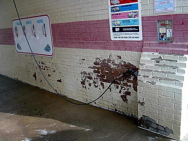

I have some pics of washes I had painted. This first one was new construction. We paid a professional painter and he did exactly what the Sherwin Williams rep instructed. The paint was oil based epoxy.
This one was an 8 year old brick wash. We used Benjamin Moore oil based epoxy and also had a BM rep come look at it beforehand. The same painter did everything as instructed.

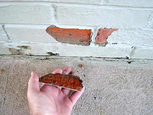

On this 6 year old brick wash we used Coronado latex epoxy. The paint stayed on great, but brick faces pop off daily.
Still wanna paint?
Still wanna paint?

Boy, a picture sure says a lot. I can see that just slapping a little paint here and there over those bad areas would make that Wash look like new. I actually think we got a better job with our painting because of the added featues. All of the paint came off around the floor where it is moist, lots of nice black mildew that eats chemicals for a living, paint doesn't seem to peel off, it just falls off in hunks. The one bad thing in comparison is that our red paint did not turn that nice pink color. Ours just faded to a dull orange. We have painted a few times to save what we can but our best results were to cover the crap up. At one location we stained the block exterior and added one block line of color. It looks about exactly like it did the day we built the location. On the inside of the bays, office and equipment, we covered it up. I suppose different things work better in different locations.
