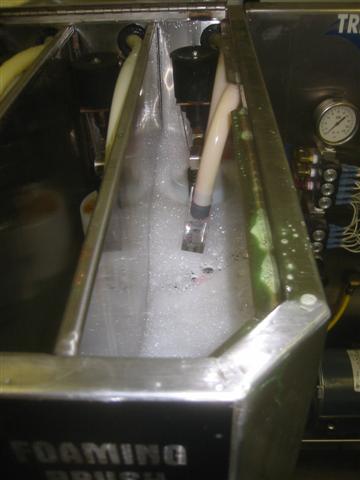

I use some turtle wax dual tip thing with a hydrominder to do the same thing though..... I know this is very descriptive. :) I will include a bad picture also. :)

I like the turtle wax ones the best because it uses normal Hydrominder tips. I have enough junk to keep up with. :) I also have some that look like the blendco dual educators but I believe they use different tips?
I could take a better picture if that is what you really wanted?

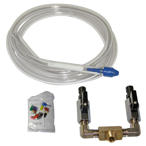

You can make your own dual-tip with tees, nipples, a short piece of hose and a second eductor. I'd recommend plastic fittings since I've had to replace the brass ones a few times due to the ultra-concentrates eating through them. There's not a chart for which tips to use to get a specific dilution since that varies so much based on the viscosity of the stock. I've figured out what tips I needed to run with trial and error.
sonny's actually sells a version for $92.... You could make the same thing out of plastic. The Turtle wax and Blendco are made of plastic. The Turtle one is nice because it is compact.... but you wouldn't have to design yours just like sonnys.
