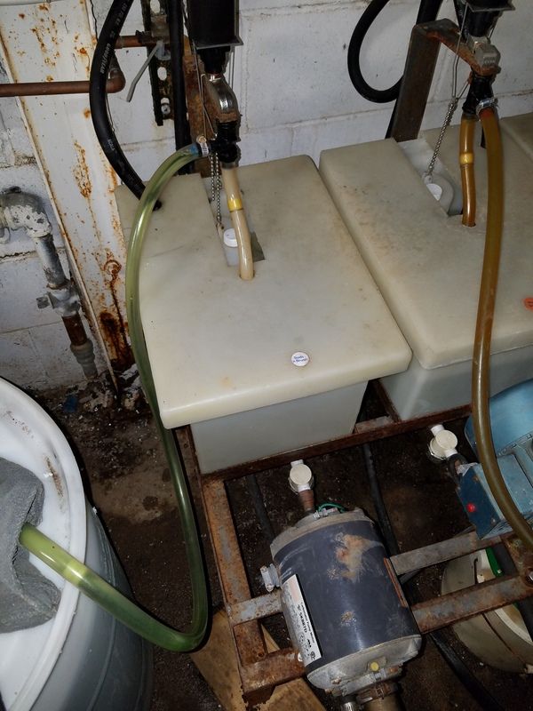

Photo of soap brush problem
Here is a picture of the foam brush set up. You can see the green soap but that should be so dark you can't see through it. I'm not saying Randy is wrong about the hole, I'm just confused because it has never had one. I've only owned this wash for a little over a year with no experience what so ever. I am somewhat mechanically inclined and can figure some things out but usually with a lot of trial and error and the error part can be expensive!

Looking at the picture it almost looks like you've got bad drum of soap. How old is the barrel of soap? Or did it freeze in the last big cold snap you had there and separate.

Can you take a side view shot of your hydrominders/tanks and post? Whats the black hose that is going down through the lid? Is that the pickup hose to your pumps? Is the soap vacuum fed into your pumps? City pressure fed pumps or gravity fed?

In the picture it looks to me like the soap drum outlet is higher than the White hydrominder tank. If it is there's no way it will back flow back into the soap drum.
