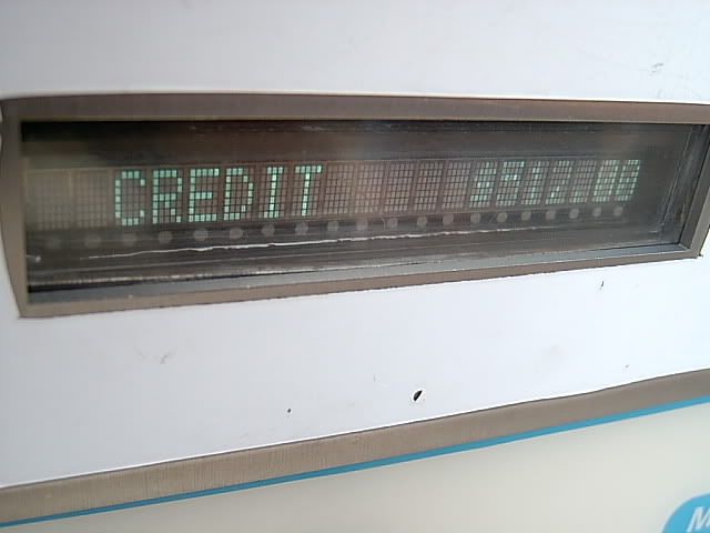

Where in the hell have you guys been! I've been bitching for years about my machines giving $512 credit, usually after a cycling of power. I even started a discussion about it in May. All you have to do is select a wash and you get all that change. Hamilton knows about it, I just haven't succeeded in getting anyone to admit it. Until now I had never had anyone else say that they have had jackpotting issues after a storm.

Thanks Brad, I would definitely like to chat with you about this. I have been screaming this from the mountaintops for about a decade now, but I don't think anyone took me seriously. I definitely want to get this resolved before I give away another hopper full of money.
