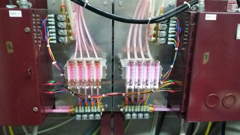

2Biz,
Is that black bulb shown within one of your previous pics (last pic on post #17) a pressure pulsation damper?
If you are gaining something with a pressure pulsation damper ... I am tempted to go that route again vs the 18" pulsation damp hoses on each of our 7 pump stand setups. If that is a pressure pulsation damper ... do you have a link from where we can buy those specific ones?
