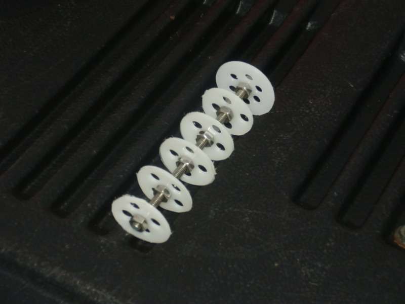

I bought a cheap toilet brush that had the same look to the spiral brush in the Kleen-Rite foamer, but when I cut it to try and use part of it in a piece of PVC it just fell apart, so that was $1.60 wasted. This is another idea:
I used a 1 3/4" hole saw for five of the disks (cut out of an empty pail) with four 5/16" in each one and a 2" hole saw to make the end disk, which has six 1/4" holes. I tried to alternate the holes as I put it together, then cut a 1/2" piece of PVC to glue into the end cap for a spacer so there's a small end chamber for the foam to flow through.
I just drilled and tapped three ports for the fittings. The whole thing cost less than $10, and that's with the stainless threaded rod and nuts.

It doesn't work as well as I thought it might. The main reason I want a foam generator is to stop the brush from spitting across the bay when it comes on, and it still does. I'll try again with much smaller holes.
