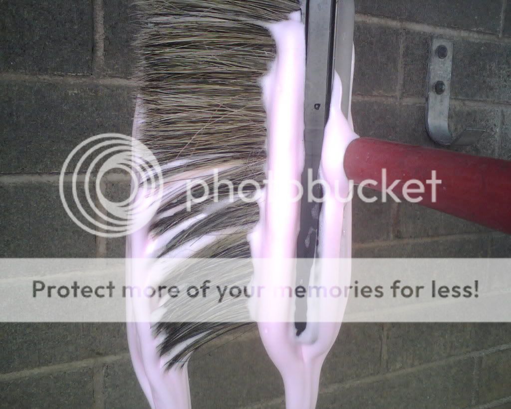

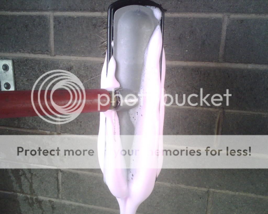

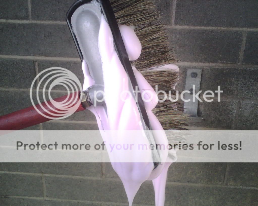

Here are some pictures of what they look like.
Good Photos, they show exactly the problem I had. I called Erie and talked to Dan and Barbara and was told that they had a problem with the manufacturer and had corrected the problem. Said they would ship replacements today and I'll return the faulty ones. The letter on the brush is an O, but that is also the same letter on the older Erie models. The problem was with the new heads with the stick-on Erie lable.
