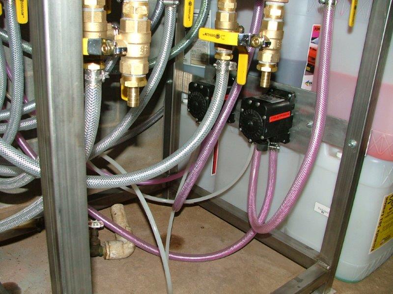

As far as welding SS goes, I know Tig is the preferred method. But you can also use Mig as long as you use the right shielding gas (Tri Mix). When I made my new float tank and hydrominder mix tank stand, I used 1.5” SS square tubing and Mig welded it using a spool gun. Turned out great and took a lot less time.

So far that has not been my experience….With either the CW or building a house! I searched for weeks to find somebody to make new float tanks or purchase ones already made the way I wanted them. If I did find one the right size, it was missing the amount of outlets I wanted plus they wanted an arm and leg for it. Over $400 per tank…And that was for something around 10 gallons. So I designed and made my own for a fraction of the cost.
As for the house… Same thing. I’ve tried hiring “So called experts” to do work I didn’t have time for. Only to have to turn around and redo most of what I hired them to do. Maybe it’s the area I live in… Maybe I’m too picky….I’ve just found if I want it done and done the way I want it, I have to do it myself.
Attached are a few pics to show the quality of Mig SS welds. I know its not a pump stand. Just showing the OP that sometimes you have to design and make it the way you want it.

I have seen many pump stand setups, I do not like the way the are built. Most are way too over built and complicated. I want to simplify the way with using the least parts, fittings, etc.
Thank you for sharing pictures of your set up. Still it looks over built which i'm sure it can be redone more simpler.

My last system had one hot and one cold supply from the tanks to all 4 pumps. If you had to work on one bay, all 4 bays would have to be shut off. So I made sure the new design incorporated enough valves to isolate the problem bay without turning off the rest of the bays...It seemed like a simple solution to me.
