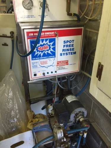

I just took a few pics inside the pump room. I'll see if I can post.

So is the sparkle system RO or DI? When he showed me this tall cylindrical housing that looked like a cutting torch bottle, he said it was actually part of the spot free system. He said a technician had come and put some chemicals in it and charged him $600. He also has a carbon filter on the spot free and a large storage tank. He said the pump runs all day to refill that tank when it's empty and that it wastes a lot of water.

I think your getting a little confused. The tall cutting torch looking bottle is likely the charcoal filter. It removes chlorine from the water that would normally ruin the membrane without it. The other filter you talk about is probably just a small pre-filter, About 10-12" tall? The purpose of this filter is to remove solids down to about 5 microns.
SFR systems waste a lot of water because they continually flush the membrane when making SFR water. Mine flushes about 2 gallons down the drain for every gallon it puts in the tank.
Did you figure out how to post pictures to the forum? Pictures will help us help you! Posting pics here isn't the easiest thing to do. A lot of us here use an image hosting site and link pictures from there. There are a lot of free ones on the internet.

I've been reading about the RO systems, and yes it looks just like one of these, but maybe a different brand.
https://www.dultmeier.com/products/0.48.902.4962/1629#
The guy thought they replaced some chemicals for $600, but I bet they replaced the membrane. He thought they were working on that tall charcoal filter, but hopefully that wasn't $600!
Is the membrane in the tall stainless tubes?
3,938
Instead of attaching files, use a hosting site (Photobucket is free but dodgy, Facebook is free, just make sure you create an album that's shared with the public, Imageshack is simple and has a smartphone app but it costs $5 a year now) then you can insert images straight into a post with no size restrictions:
I don't see the stainless tubes in the picture, but that's where the membranes are. Hopefully for $600 they should have replaced the membranes and the charcoal.
