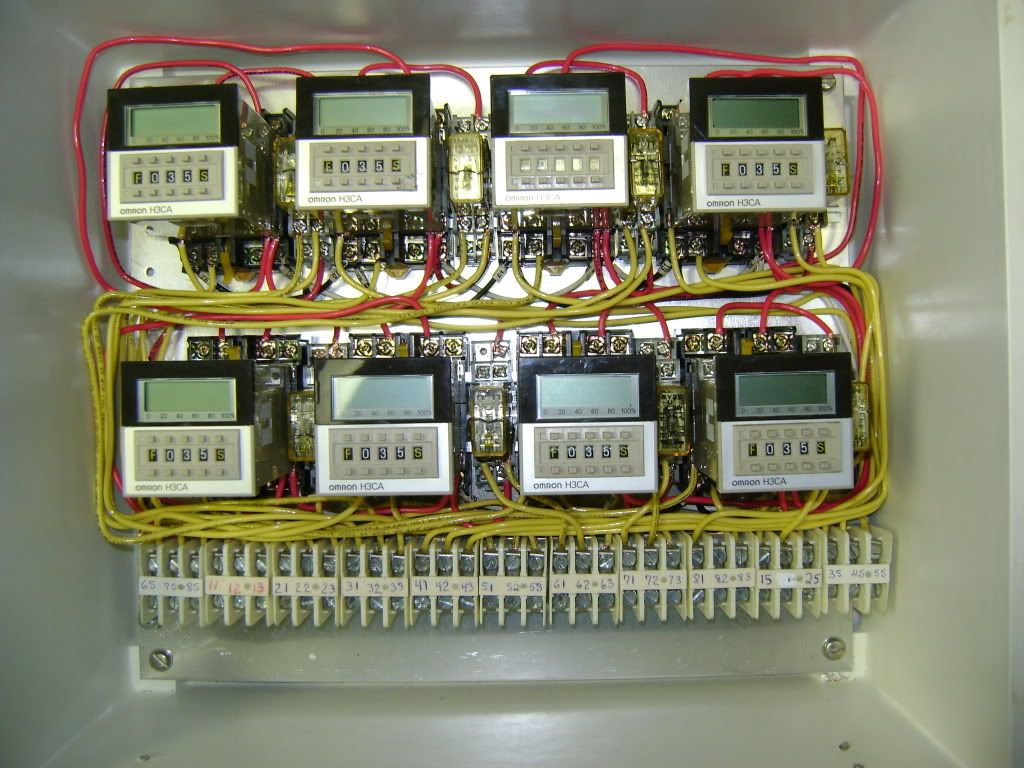

I have timer relays that will reset every 15 1/2 hours (or from .01 seconds to 999 hours). They require very little amps to run and the supply voltage range is 240 VAC down to 5 VDC with no modifications. They are Omron timers and last for a very long time. I have used them in my race car to run the cooling fan between rounds. I am sure I have a used one around that I can make you a deal on.

Here is a pic of a foam brush purge kit I made using these relays.

You would only need one relay, I was just showing you a pic of what they look like. As I staed I use them for controlling circuits in the race car and they work great. Too bad could have made you a deal......
