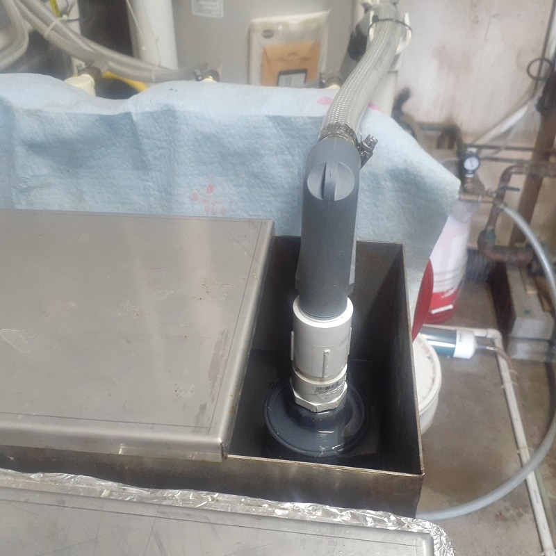

I just slid my lid back. The valve takes up about 4-5" in the corner and you don't have to worry about a float. I'll snap a photo when I go up there today....I'll be able to get rid of this valve when I install my 1.5" softener...Head pressure goes from 20psi for the 1"to about 4 psi with the 1.5"! When pressure drops to 30-35psi incoming, I start seeing issues. At 40-45 everything is ok! This winter, a huge main that fills the tower that I am on ruptured and took them a while to discover the leak...The tower darn near ran out of water,causing the Low Pressure. How do you plan for everything that gets thrown at us!
2,785
404
Here ya go....I see your delima, my issue is hopefully temporary. I keep this area covered with a micro fiber towel to keep any debris out of the tank...
