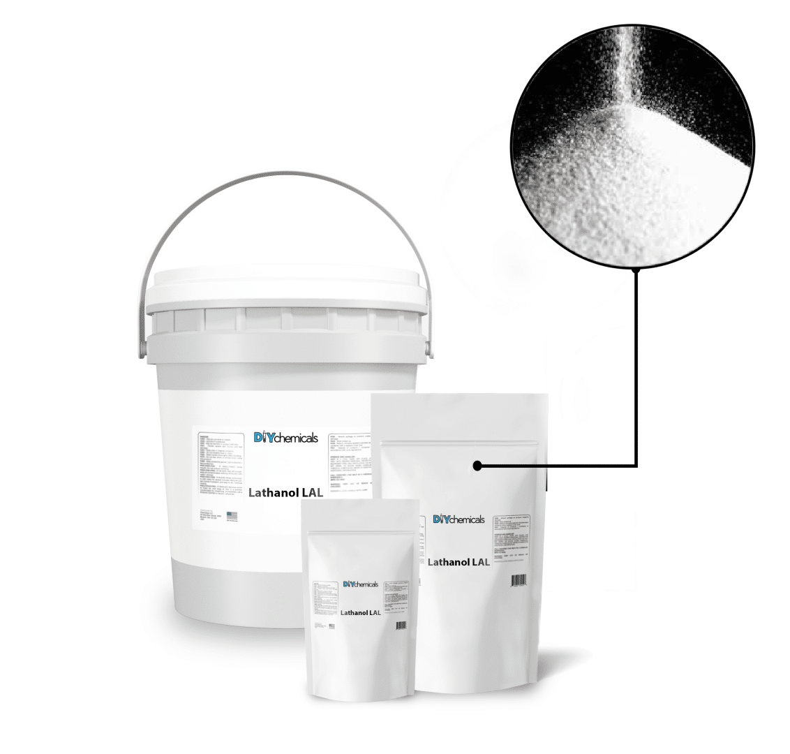

There was a guy who used to post on this forum named Bill Consolo from Chief’s Car Wash in Cleveland, Ohio. He used to make his prep brush soap for his tunnel from a bulk ordered flake product - I think it was similar to this:
The highest purity, concentrated, Lathanol LAL delivered to you. This pure Lathanol LAL is what you've been looking for! Various sizes available.
diychemicals.com
Maybe you can contact him or dig up the old thread to see if he named exactly what he was using. It did not require him to make it from scratch, which I would not attempt, but gave him a more economical solution for brush soap that he could mix on site. One thing I would recommend - when you mix any dry ingredient with water, never use hard water. Make sure your water is as close to 0 TDS as possible. The minerals present in the hard/non pure water really counteract the soap ingredients when you are formulating the concentrate.
I found it - Witconate Flake - 50 pound bag. 16 year old post. Amazing my mind remembered this. Wish I could remember what to get at the grocery store!
