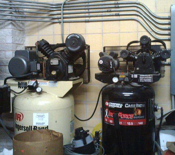

I couldn't risk the problems again that we were having when the single I/R compressor started tripping the breaker:

It has nothing to do with manufacturing, it has to do with cheap Chinese junk. Brand name means less and less as everyone goes Chinese (even their cardboard is low quality). Look at the picture Mep1 posted, both compressors are Chinese throw a ways. I would always go for the 3 phase if possible. Our supplier sells Curtis and he installs the motors and compressors himself, I choose the level of quality. Mac is right on the price of a decent compressor (1200-1700).
3,938
The Campbell Hausfeld says Made in USA on it, but I don't doubt that some of the components (The motor for sure) are made in China. The original motors on the I/R are junk and cost much more than the Baldor I replaced it with.
