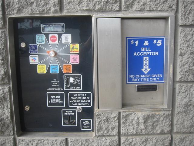

Well it is time to get rid of the Coleman Swipe-N-Clean at my wash. I am looking to upgrade my Coleman boxes and add something that both adds bill acceptor and credit card in the bays. I am looking for a direct door replacement and I could only find Etowah Valley or Carolina Direct that make direct door replacements. I am looking at two options and would appreciate opinions from those that have already done this.
Option #1 - Purchase Coleman door replacement from Etowah Valley and get Dixmor LED 7 timer along with mars bill acceptor and add Crypto Pay for credit card acceptance.
Option #2 - Purchase Etowah Valley coin box with the EV timer that has some great marketing features. Also use the EV credit card option which I believe also now supports wireless connections for adding vacs and vending machines to the network.
Comment ? Thanks.

If you can locate a distributor that works with Dralco, they can make a custom door.
6,212
792
I thhink a concern for adding a bill aceptor to the box would be security concerns. How will the new door be concerned.
Do you anticipate issues? If so, perhaps a seperate box is a good option. Ifd they trrash the seperate box trying to get bill the bay will not be out of order.

Why are you wanting cryptopay instead of the quick pay that etowah offers. Inamalso trying to decide between the two. Jim will sell the box without credit card and the dixmoor timer an then you just add the cryptopay. I think that Jim also has a wireless version of the timer for adding credit card at the vacs
Doesn't the ev system use a proprietary timer? That might be the best reason to select the crypto system? I would also check both cc processors cuts and if you could change cc processors.

I would replace with coleman doors with bill acceptors and put in crptopay cc system. I am looking at that also. bill acceptors are expensive. Dont know if its worth adding a bill acceptor and a cc system.
Just a thought.... you could use the cheapest bill acceptors you could find. Like a Pyramid bill acceptor. I don't think anyone is going to string a bay to get a free car wash?
Another thought... I purchased some crap MEI bill acceptors off ebay and Super Randy fixed them up for me... good as new and still saved me a lot of money. Randy even got to keep an acceptor. :)
