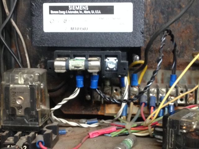

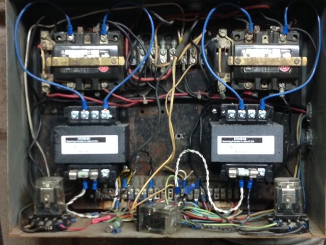

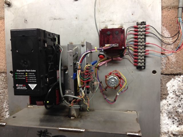

I just attached a few pictures of the control box, transformer, and coin box. If you look at the coin box terminal strip, the first 2 wires are incoming 24 v power from transformer. When I touch the white wire ( 2nd wire on terminal strip) with a bare wire and touch it to the stainless coin box, I do not feel anymore shock. If I remove the wire I start to feel it again. .

ONCE AGAIN, that's only recommended if the transformer actually has a neutral side.
Before you argue, there is nothing wrong with a floating common. It's just different from yours.
RAATCB
Oct 12, 2014
151
CO
MEP001 - did you see the pictures I posted? Can you help me out ?
I can't tell much from the pictures, mainly because the print on the transformers is completely illegible.
