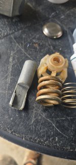

Check your screens in Your Water Tanks
water guy
On our razor our screen inside of water tank worked loose and my low switch was worn out and the top part came off and got sucked into the pump all the way to the bottom valves and the top valves on the cat 3535. Somebody called Sunday and said automatic sounds like a helicopter. And this is what I found. Even found a magnet that goes inside of it.1000039878.jpg
