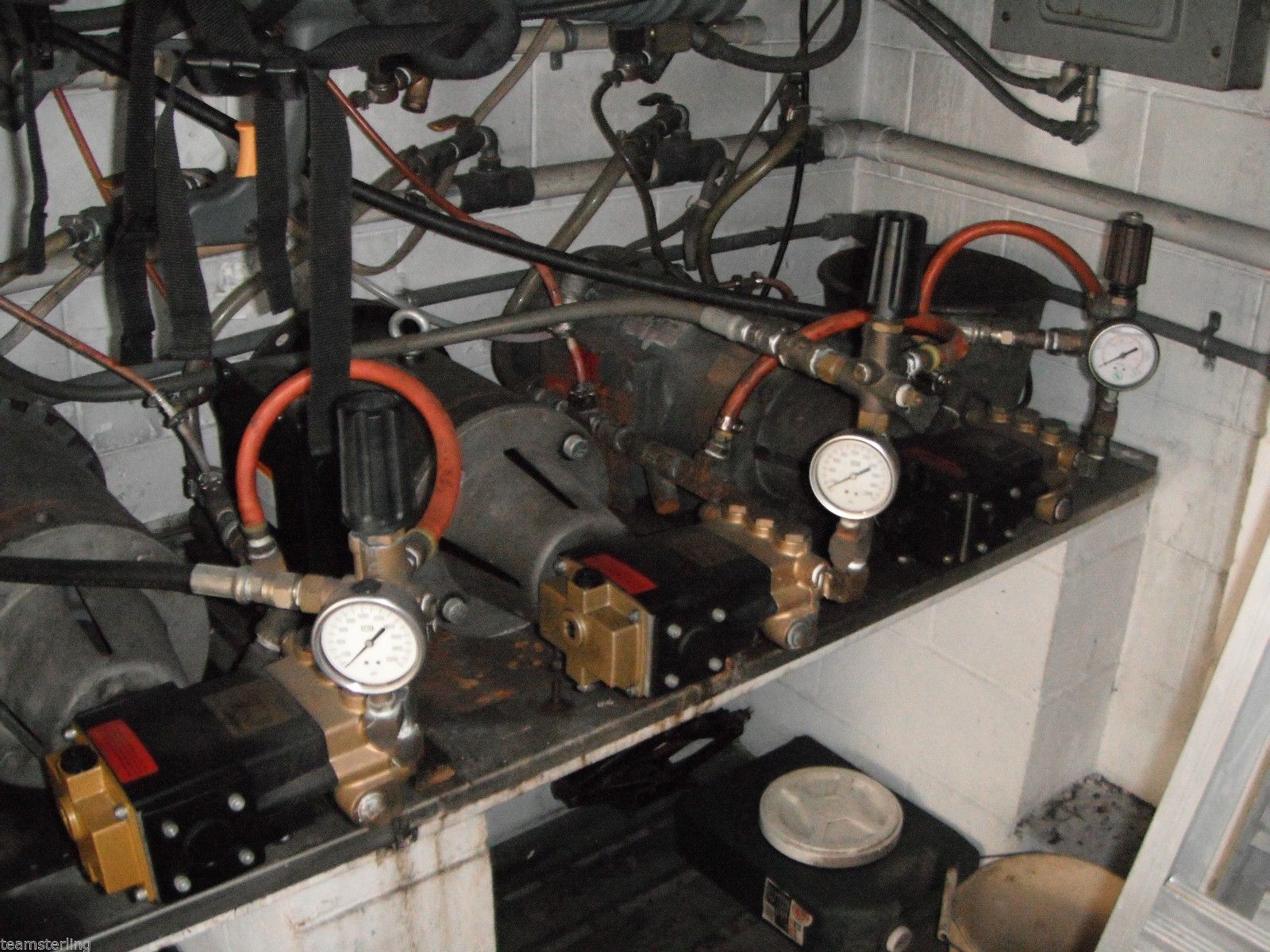

Windtrax in Kansas City is a smaller company and will make you a pump stand after explaining what you need.
Why not direct drive or a pressure washer? Yes direct drive isn't as desirable but if there is a problem with framing the system or whatever?
Not my stuff.... Picture from ebay.
