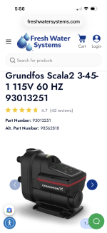

i have been using this pump at a couple locations and am only getting 2-3 years out of them. looking for a different one to use as these are about $1000, has anyone used anything else that they are happy with that last longer and can suggest?

I've been using various Goulds Centrifugal pumps I had laying around, they last decades. Maybe its more about how you have it plumbed in. Where and how is it plumbed into your automatic? How are you turning the pump on and off?
