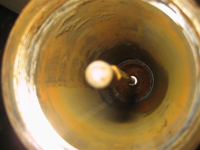

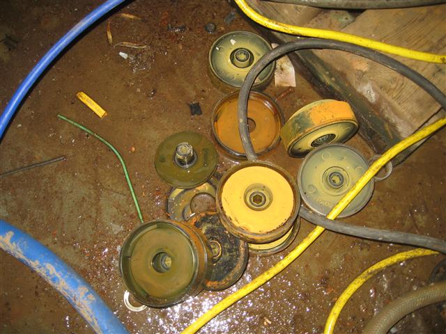

Not sure if you looked in the housing but there is lots of crap in it.... it would also seem like a lot of trouble to switch it out? But I just replaced mine after someone talked me out of what you want to do. :)
Oh and my head just fell off.... or my pump head rusted off. :)
