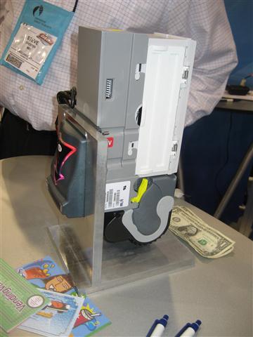

I don't understand on the following link about the MEI automatic bill recycler OPTIONAL FEATURE. It seems like it could be a good concept. Does it dispense some bills (when available) but not as capable as a note cassette would? Anybody know if it is perfected enough to trust in a limited way? Randy? http://www.standardchange.com/changers/mc630rlda.html

The Mars/MEI bill recycler holds 30 bills, either $1’s or $5’s but not both. It will only work with a machine that uses a MDB protocol. This would be Standard, some Rowe and American. The problem with the recycler is the recycler portion of the validator sticks out the front of the machine, this makes it easy to attack. If you knock the recycler off the front of the machine you’ve got a 3” x 4” hole in the front of the equipment. I wouldn’t recommend any bill breaker or bay bill validators for any location at is in a questionable crime area. As our bill validators in the bays are failing or are vandalized we aren’t repairing or replacing them. The trick here now is to steal the ATM, ACW or the bill changer, in less than 45 seconds it can be gone.
The recycler module is able to be added on any acceptor in that series. The bevel is also just an option for any acceptor in that series. The doc says you can use the standard bevel.
The acceptor just rolls up bills in a spool and dispenses them. It keeps the bills it is going to dispense if the acceptor is low and someone deposits that bill in the acceptor. It is just like a normal acceptor when the recycler is empty.

It looks like the recycler could be a good fit for some operator as long as the operator selected $5s for the specific denomination of bills kept for standby & subsequent output. Maybe Uncle Sam or someone can share what the reliability factor is for the recycler based on actual long term use???
I am pretty sure all modern vendors are mdb compatible.
Also in theory your customers fill your breaker (I believe it is 30 it holds).... Like the coin dispensers in vendors.
