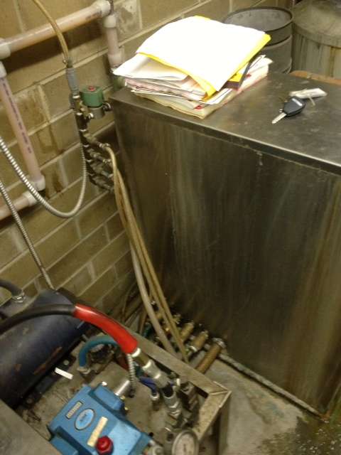

I have a standard old style 4 bay car wash.(can be seen on my profile now I think) I am having some issues and need help with a few of these. When #4 is in use water spits out the holding tank overflow tube inside the mechanical room. It does not do it on any of the other three bays. Another issue that I noticed yesterday evening while washing down #3 I heard the brush hanging on the wall gurgle and it started pushing out some water and soap. The selector was on rinse. I had heard a customer come into another bay to wash. I peeked around the corner and there was a guy in bay #2 with the soap brush in his hand and soap and water was coming out as it should. But I have to believe that the usage in two had something to do with #3 acting like it was starting. I messed with it some after #2 was empty and noticed that when applying presoak it was very "hit and miss" as for the distribution of the presoak. Meaning it was making the noises but presoak was not coming out continuosly as normal. Those that are not completely confused please give me your thoughts. Happy Daze

I forgot about your pictures:
That problem is a check valve. It looks like there's an individual check valve for each pump supply coming from the bottom of the tank in the last picture.

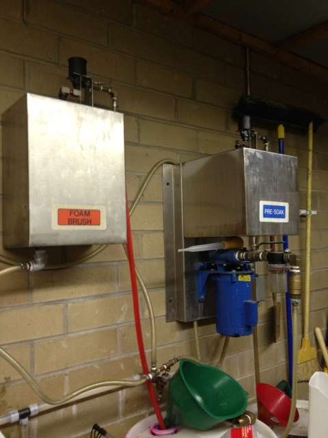

That's also a check valve. The foam brush distribution system in your second photo shows a weep system with check valves - the one for bay #2 is bad.
That's probably in the adjustment. If there's an individual valve for each bay, try turning the air down until it comes out smooth. If it flows too slow when you get it smooth, increase the liquid flow. If it's a problem with the weep check valve, you'll see water running in that bay when one of the other bays is running on high-pressure.
