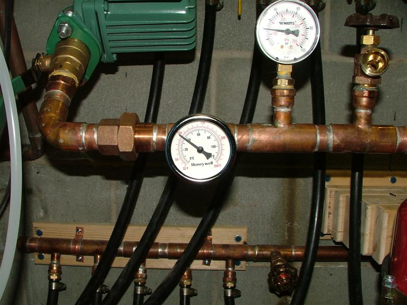

I looked at your video again and saw five gauges but you only showed two of them. I'm not sure which ones of the other three are temp and which ones are pressure.
2,785
404
Its just before the main circulator...Of the two gages shown, its the one on the right....This picture was taken when I fist started up the system. I had it set to 20psi...Later, changed it to 10psi.
