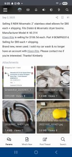

In case any one is interested, I'm selling 5 NEW Mosmatic 2" stainless steel elbows for $80 each + shipping. or OBO. Fits Diskin & Mosmatic dryer booms.
Manufacturer Model #: 60.314
Kleen-Rite is selling for $106.54 each. Part # BOMP60314.
Brand new, never used. I sold my car wash & no longer have an account with Kleen-Rite. Please contact me if you're interested. Thanks! Kimberly
Here's the link - https://www.carwashforum.com/threads/5-mosmatic-dryer-elbows.26571/
