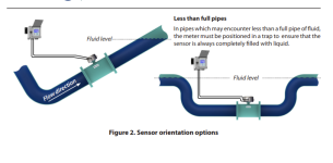

On that website which one would you choose? Also, I'm trying to find someone who has done it. In a P Trap would it be mounted at the bottom of the U or at a 45 degree angle off of the U?You can use an ultrasonic. You just have to put a "P" trap in. That should be no issue on a 4 or 6 inch line. Just be sure to have a clean out at that point. Go to www.mccrometer.com
